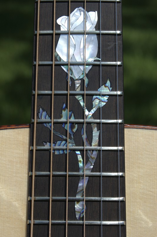

Great to have ya around. I thought I would post a pic of a rose inlay I did a few weeks ago. I know you are leaning towards using wood and mine was shell but I thought I would post it for interest sake. I like the shell because as Craig (clavin, the local expert) said you can get some really cool patters that look great for the leaves and other parts of the stem. The stem on this rose if Paua with a few small pieces of Green Rippled . I'm no inlay expert and this inlay has its flaws, but it still looks nice. So for what its worth...
Hey did someone mention Tim-Tams?? A friend of mine brought some back here to Canada. I wish we could get some of those up here. They were great!
